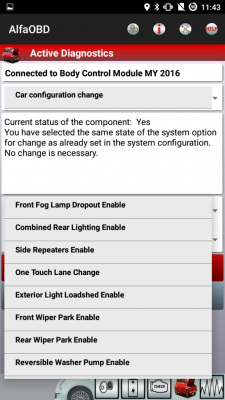

I read the entire thread and also looked at the Google drive document of confirmed add-ons, but I didn't see where someone added/enabled fog lights for a Tradesman truck. Forgive me if I overlooked it.
With all the stuff it does, surely it can enable this function.
I also have a compass module that come with my overhead console that I'd like to put in.
Can anyone confirm if either of these options are present?
I went ahead and ordered the OBD MX Bluetooth adapter anyway.
Thanks to everyone that had a hand in this, as I think it's a really powerful tool and I'm excited about the possibilities.
I believe I have seen all of these present but can confirm for you while you wait for yours to come in. Along with the program, OBD MX and Android/Windows device you will also need the security bypass harness from DeereGuy for 18' trucks.

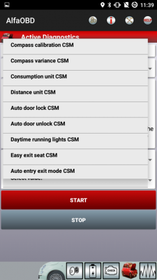

Thanks for looking into that...and for the reminder about the bypass harness. I PMed DeereGuy to place an order for one.
Found these settings with a quick scan through mine. Could have missed something though.

Im not sure how i did it but I think i enabled he compass in my truck. I was playing around with the app I selected something to do with the compass, and I dont recall selecting any changes cause I dont have the module, and now I had dash marks where the compass readout would be in the EVIC.
