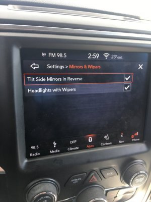

How do you know if you have the correct mirrors for the tilt in reverse function to work? I have power/heater/folding mirrors currently on my 2500.
Ricks Ram
May 1, 2015
4,411
3,415
Normally the Laramie and higher trims are the only ones that come with the memory mirrors. To make sure you need to pop off the door panel and if the white mirror plug has more than 4 wires in it you have memory mirrors.

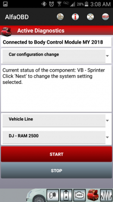

Ok, I finally figured it out. If this will help anybody else, then my frustration was worth it. ..
I connected to each module that I thought would cause each particular error message on my EVIC.
First , the ABS
It wouldn't leery me clear the fault code.
"Vehicle Configuration Mismatch"
got my attention, so I moved to the next module. ..
Gibbs
Dec 22, 2017
241
131
GA
6.7L Cummins
Next, the Airbag.
It wouldn't let me clear this fault code either.
"Vehicle Line Mismatch" really got me to head scratching!
I poked around some more and tried to find something that was related to Vehicle Configuration Mismatch or Vehicle Line Mismatch. So back into the BCM and I found a setting for Vehicle Line, which sounded promising
Gibbs
Dec 22, 2017
241
131
GA
6.7L Cummins
I selected it and hit start, and I saw this
Holy crap Batman, I somehow changed the dang vehicle to a Sprinter van! !!
No wonder it didn't work right!
I changed it back to Ram 2500-DJ
and everything is back to normal.
Lesson: don't stay up way too late when you're half brain-dead and prone to make touchscreen errors and not remember what you did, lol.

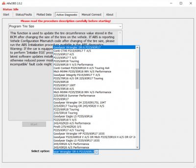

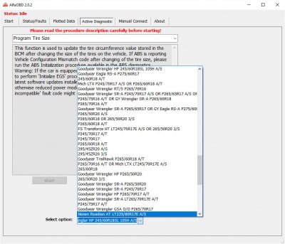

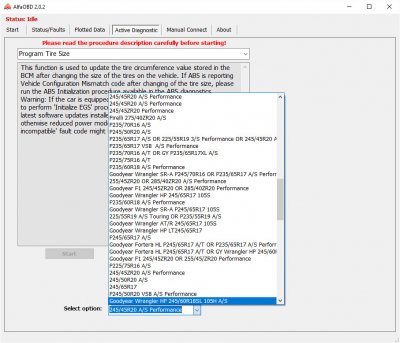

I need to get you a screen shot of the tire size screen. I didn't see a way to enter your own value; rather it had a long list of tire sizes pre-populated.
The funny thing is, the last one on the list was Toyo Open Country ATII 35x12.50 !!
I didn't actually change anything in there, I was just looking around.
I remember @chamolie said his friend ran into problems trying to change the tire size, so I left that one alone
When I changed Update Pressure Thresholds to 65 psi rear, it changed the EVIC warning on the dash to say "Fill Rear:65" instead of "Fill Rear:80" but the warning light was still flashing. I didn't note any other errors, but it was late and I was brain dead, lol.
chamolie
Jun 18, 2017
73
37
2016 SLT
Cummins 6.7
Yes, I did change the tire size back to "BS/FS LT275/70R18E A/S" and afterward had to Clear ALL DTC before ALL errors went away. Did a dump of his System ID afterward and compared with Mine, his truck is 100% now.
I have attached screen shots of ALL programmable tire sizes from the AlfaOBD version 2.0.2
Notice the highlighted selection in the last image, this was the tire size selected to return his 2016 RAM 2500 back to normal...
