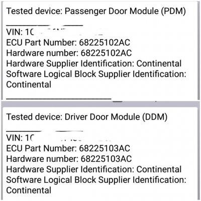

For those that are looking, I confirmed the CC Door power fold modules used in my 2013 Ram1500 SLT Sport mirror upgrade are the same as the factory ones in my 2018 CC (via the AlfaOBD)...
Door switch i issued was 68110867AB
And Flat black Sport/Bighorn mirrors/modules in bold on my 13…
(Pwr Fold, Heated, AutoDim w/o color, w/puddle/signal)
(R) Pass Mirror: 68231240AD (GuK) Dr Module: ____68225102AC____
(L) Drvr Mirror: 68231241AI (GuK) Dr Module: _____68225103AC___
Keep in mind these are not the Chrome Laramie style memory mirrors. Note sure about the PN for those, but the modules do support memory if the CSM module is also installed.
