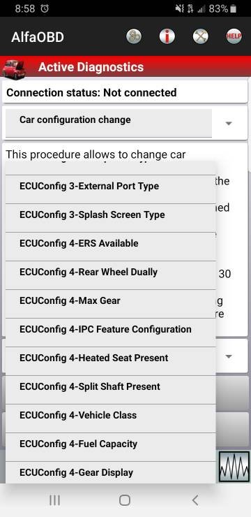

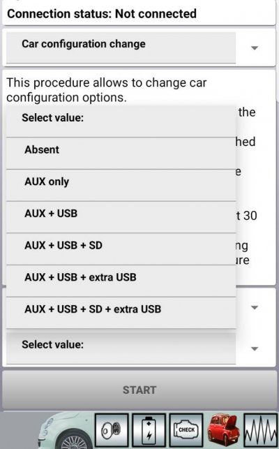

ok someone else had this problem a while ago add my cd disc and update my bcm in alpha by adding usb aux and sd card since my new console had cd now my problem is that I changed my old vp4 2013 for a vp4 2017 and still disappeared my aux usb and sd card I tried to look for it in alpha as I did a while ago but can't find external port type my truck is a 2013
Car Config change... Ecu 3... External Port Type...

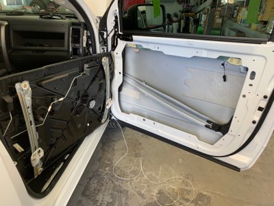

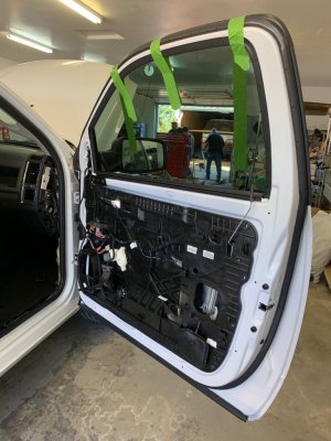

I spent the morning till about 2pm today with Rick "Ricks Ram" and Nathan 'STecoD" while they installed passive entry and push button start in my 17 Ram. These guys are one hell of a team, concord this install super fast and the install quality is second to none. Everything looked like it came with the truck from the factory down to the wiring, wire sheathing, connectors and placement. Better yet once all was programmed via Alpha everything worked perfectly on the first try. I do have to say that I am blessed to have these guys for my friends. They worked very hard today in the valley heat for a guy that was a stranger just months ago, thanks again guys for all the hard work. :)
M² Mods.
I can't find it anywhere, someone else with a 2013 has this problem I know that in the past I had it when I added my cd disc eh I send an imail to the developer but I continue without any response thanks mike this is how mine looks
