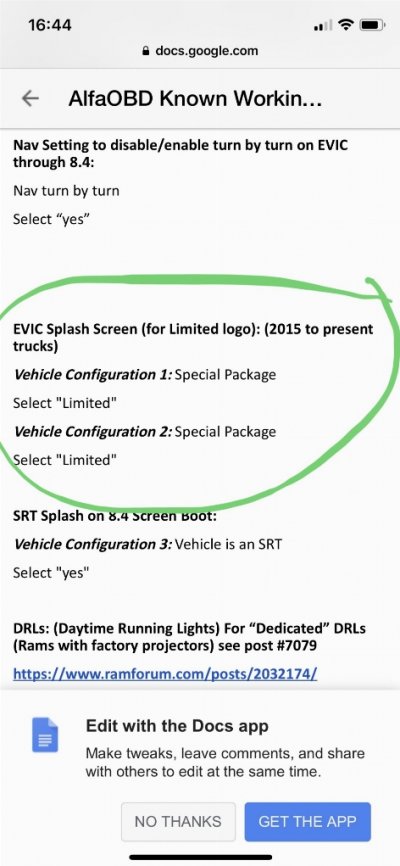

I know it mentions special packages but for the life of me I can't find that option anywhere. Unless I'm just scrolling too fast by them. When I reset the mileage I got a cool continental tire splash screen and I wouldn't mind having that all the time.
Sent from my Pixel 3 XL using Tapatalk
You have to connect to the body control module.
Program custom features. And it’s in there.

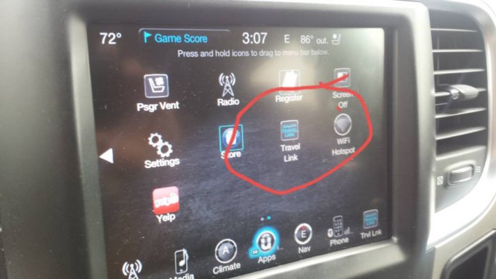

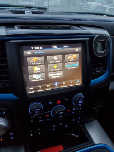

The U.S trucks equiped with factory Nav came with the Travelink free for five years starting in 2015. The Canadian trucks did not have this feature. I noticed you said the icon was present on your screen but I don't see it in the pictures you posted. Do you have the Travelink icon like this in your Apps screen?cfc5ac02014570474d72b10ae14c3de5.jpg

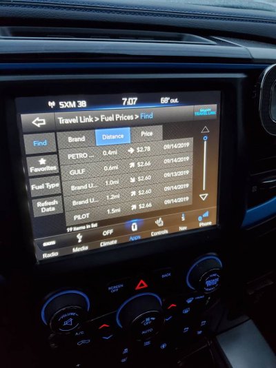

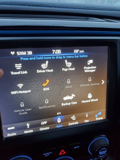

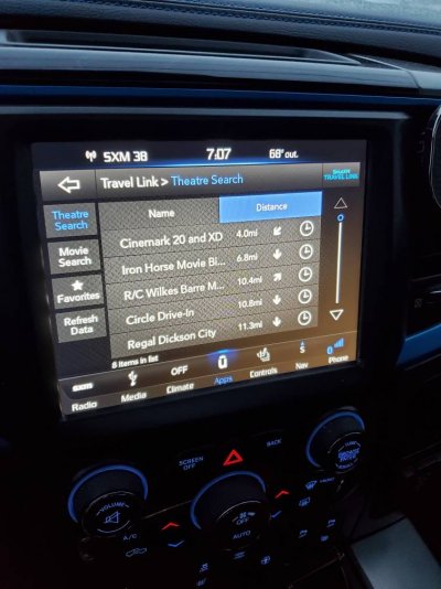

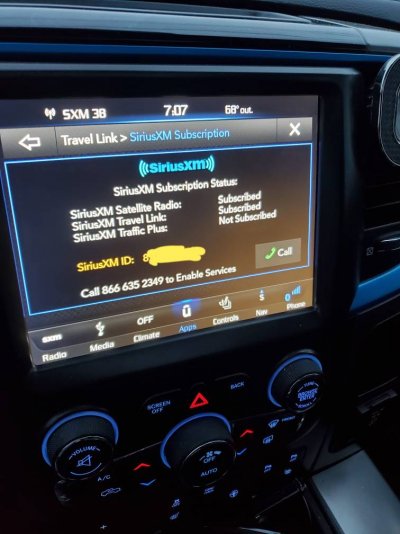

Adding new screenshots. Travel link appears to work, it's just traffic that shows not subscribed. And if I use the nav, I dont get any traffic updates or anything else sirius lists as part of traffic plus.6d6e72ac9c6f08d1c33969dfbf1090da.jpg1d16f95ca70d92a969380929d21ed13a.jpg12f1a563691c5521e595f6eab646d440.jpg0731b9e55f58e924a683acee87b57326.jpg5dfeecd9f9051a4b766e6aeef09c31d2.jpga1bfa04d7d69a8772fcb6e821537370f.jpg

If the Travelink icon is on the screen on a UAQ radio the code is enabled in the BCM. It seems to me like your real time Traffic is not subscribed. I would call the number for Sirius customer care that is on your emailed receipt to get it resolved. I have never had any luck using the number fof the subscription center getting anything done.
I will try that tomorrow, just wanted to see if it was a bcm setting. This is even more unusual that the truck is canadian and had travel link when I bought it... granted the evic reads mi and not km, so maybe when it got imported to Detroit it was reflashed somehow before it got sent to the dealership I bought it from.
