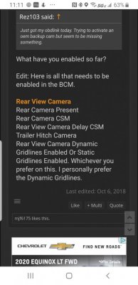

When looking through body computer the only thing i cannot find is
Trailer hitch camera.
Where is it?
Where is it?
What year is your truck? The Trailer Hitch camera wasn't an option until 2016. If you have 13 to 15 it will not be in your BCM to enable. If your truck is a 2016 or newer the option should be present.

So would i need new mirror?
Both cameras show up in uconnect with blue screen i enable them, but something is not connected.
I pulled radio and do not see any rca plugs.
