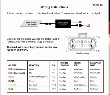

Please forgive me if this has already been asked, I looked through everything and did not see this question.
I have diode Dynamics switch backs for my turn signals, I have turned on my DRL with ALFAOBDand told it to set the DRL to turn signals, however it comes on on a different voltage and does not activate the white side of the switch backs. Is there a way to make this work?
Problem- I want my DRL to be the white on my turn signal switch backs, but the DRL only activates the amber side of the bulb.

You can’t set DRLs as turn signals for switchbacks, because that’s what will end up being the DRLs....the amber turn signals. These are the settings you need:
DRL configuration >optional
DRL lamp location > dedicated
DRL dropout enabled > yes
CBC I/O right dedicated DRL lamp output present> yes (should be yes already)
CBC I/O left dedicated DRL lamp output present > yes (should be yes already)
LED dedicated DRL present> yes
ECUConfig 3 DRL customer setting enable> yes
CustSetMenu 1 daytime running lights CSM> yes

Well dang, ok that’s what I have set up now. Guess I’ll change it back to headlights and look at my options for LED’s ....just never been happy with LED’s for my headlights...but I like the look it gives the truck

Do you have the red wire from the DD drivers tapped into the truck’s dedicated DRL wire? That’s the only way it will work like this. Vrwv2YB.jpg

Ha nope, I have the poor man’s headlights....just the bulb installed. I would love to upgrade to the projector style headlights but can’t just yet on my truck....doing a few more things to the wife’s first.

Ahh, sorry. Every time I here DD switchbacks, I automatically think of their boards and forget about the bulbs. You can still make it happen with those settings, but you have to add the dedicated DRL wires and tap them into the parking light wires with diodes.
