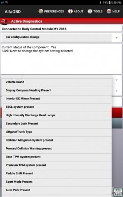

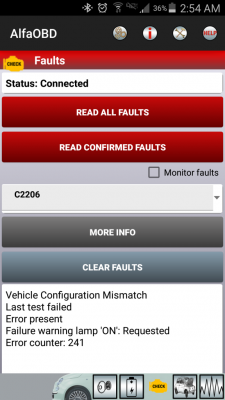

Im not sure how i did it but I think i enabled he cumpass in my truck. I was playing around with the app I selected something to do with the cumpass, and I dont recall selecting any changes cause I dont have the module, and now I had dash marks where the cumpass readout would be in the EVIC.
Do you know what you selected for compass? I have a compass module I plan on putting in and would like to confirm how to enable it.
I got my security harness today (thanks @DeereGuy ) but I'm so busy i won't be able to play around with it until tomorrow or Monday.
It's under safety and driving assistance in your settings menu. Remember you have to have the correct mirrors or it will not work. My truck is a 2014 and for some reason when I select the option on my screen it unchecks itself but as far as I know my truck is the only one that seems to have that issue which is annoying. Also remember sometimes the truck has to go through a few sleep cycles before the option will show up on your screen

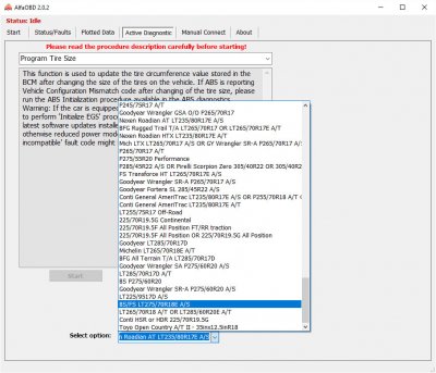

2. "Program Tire Size" I was looking around but didn't change anything. It was set to LT275/70R18E A/S
3. "Update Pressure Thresholds" I knew it wouldn't get rid of the warning light, but I changed it to 65 psi rear just to see if it changed on the EVIC (it did change) I changed it back to 80 psi.
I went back to Pressure Thresholds and they were set 60F 80R as original. i went thru the procedure to change them anyway.

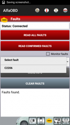

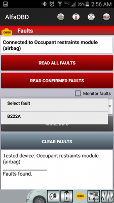

I had the exact same using AE a few months agon.I changed the vehicle line by mistake on my 2016 ram awile back and i had the same error codes and my bcm was corrupt .
I changed it back but it was a one way street .Dealership had to reflash my bcm twice to get fixed .
It’s nice to know that alpha obd is not just a one way and no return like AE.
I learnt my lesson on that mistake to be very careful .

@Gibbs So were you able to change the size and pressure in the end? These are the 2 options I am really interested to see if they work. So far it does not appear they do from what I have seen reported?
I know to get the tire pressure to work you need to reset the RF Hub to finalize the setting (you need you vehicle PIN to do this). I believe another tried but got a invalid PIN message or something like that?
I didn't actually change anything in there, I was just looking around.
I remember @chamolie said his friend ran into problems trying to change the tire size, so I left that one alone

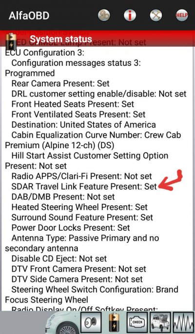

Being as my VP4 was out of a 15' Limited, it came with 5 years of Travel Link and was already under apps. Does the newer 2018 UAQ radios not have Travel Link already in apps? I too enabled this thinking it might be something different than what I already had but seen no change. Unless this is something different.@Gibbs
Great info/post. Thanks for sharing the details.
Swapped out the 2018 UAS 8.4 radio for the UAQ radio (w/nav) that I had from the previous truck ...
Enabled the TravelLink feature under the ecu3 section...
** It took a few days before the icon finally showed up on the radio under the Apps section (set it Thursday, showed up Saturday on my drive to work) ....
Enable TravelLink on 2013-2018 8.4 Nav Radios
-> car configuration change
---> SDAR Travel Link Feature Present : SET
(It's about 3/4 easy down the list)
