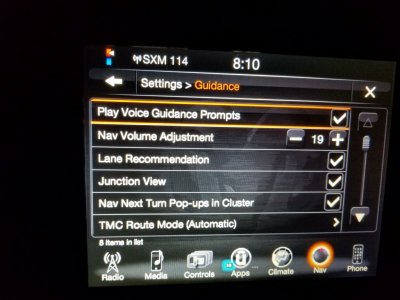

Does your evic show nav pop up turn by turn in the menu setting area like ,display fuel saver, lights on with wiper etc..

I have a 2014 RA4 and a 2014 premium cluster both added after the fact and turn by turn works in the cluster.
Can you post a picture of what the radio setting screen with the turn by turn looks like on your radio so I can compare it to mine...
Are you asking about a specific menu in the radio or the cluster? If radio I currently have a newer UAS without NAV installed but I can check in a couple days when I replace the touchscreen with my RA4.
If you mean the settings in the EVIC, I was never able to get them to appear in the cluster. Maybe that's the difference?
