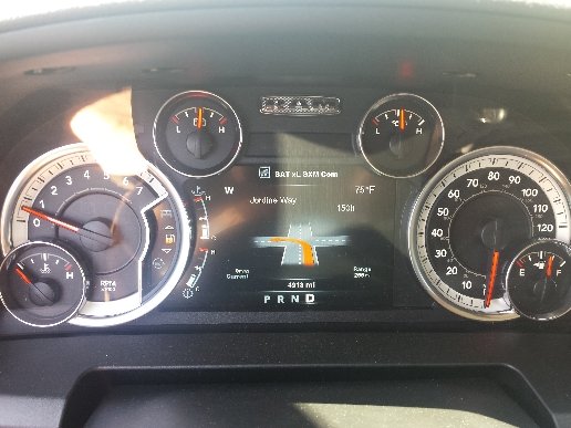

I have a 14 Express and upgraded to the RA4 with the 7" premium cluster and the turn by turn on the cluster works fine. I have done a few other trucks and they have all also worked. My truck is a 14 with a 16 radio and a 13 speedo. The one thing I'm not sure of is whether or not I have tried a 16 or newer speedo in a 14 truck. I have seen a few guys post that for some reason the graphics for turn by turn aren't working but it seems to be an intermittent problem that affects some but not all. This is a pic of my 14 Express with a 13 speedo and a 16 radio. 3c782a5f8a24d60a8de918ee4826d29e.jpg

I thought it should! What the heck is the problem with mine? You have the arrow graphic?
