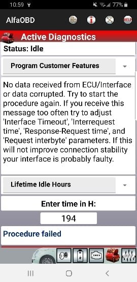

This is message I'm getting when it fails to world-changing hours for 7" evic9ca2b0c7fed3640b9a41ddc02ec17a81.jpg

Is your obdlink up to date? If you download the obdlink app and connect to it you can check for updates

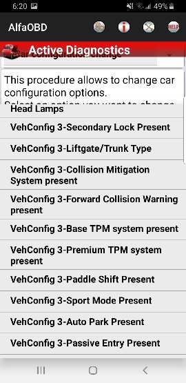

Yeah I just updated the obd2 reader, that didn't help, as for tpms not showing up I briefly looked in body computer and saw these 2 settings, didn't try to change though 137bdf95662f1aa344850818bdd2305b.jpg

Premium should be set, the base is what duallys use. Basically turns off any warnings but allows you to see the pressures. So if you double check your logs and nothing was changed then it sounds like the 2014 cluster isn't compatible with your tpms.
As far as hour's go, it looks like your options are keep trying and hope it eventually takes, wait until Alexey comes out with a fix or try an earlier version.
