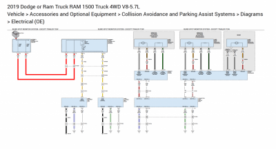

Does anyone know what settings need to be changed to turn on the front parksense? I have everything installed though I’m not sure which items to change with alfaobd.
@skuppy069 may be able to point you in the right direction.
