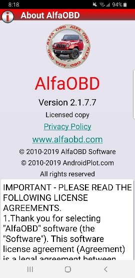

I’ve been running into the same issue. What obd are you using?
I bought the mx bluetooth adapter and this is the version I have of alphaobd,,,
P.s I was able to do the tpms reset by using directions from a YouTube video,, no issues doing that just got mileage change also but can't get engine/lifetime hours to change2998bc5e6e719ac4c9029dc7c64d6b63.jpg
Sent from my SM-G960U1 using Tapatalk

Are you using android phone or laptop?
I tried both, couldn't get it to connect were with body computer from phone, but it would connect on Samsung tablet and that's how I changed mileage

I was able to change my mileage just fine. First try. It’s my idle and hours that don’t work. I have been in contact with alexey and him and his partner are working to solve the issue. There have been several requests to get this fixed. So for now just hold tight OR keep trying.
