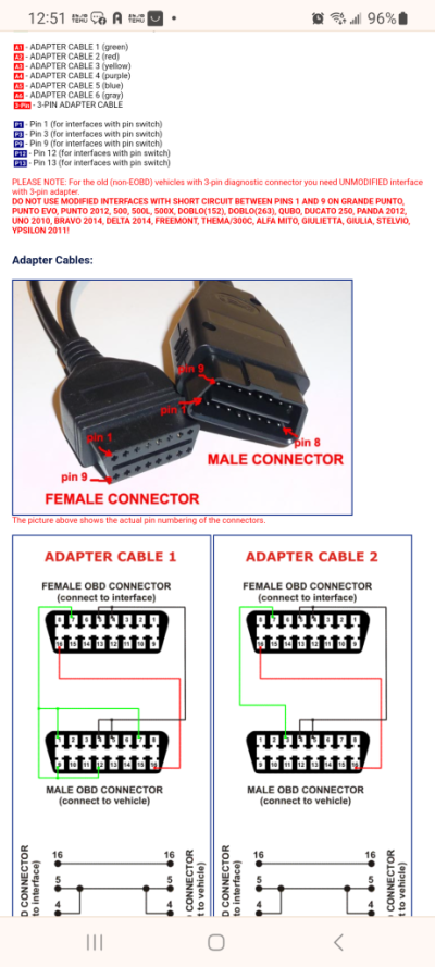

Hi guys I found this page on the multiecuscan supported vechicle page that shoes the wiring to make your own colored adapters.
Scrolling to the bottom of the page.
The only thing I don't get is there is a picture of the two connector ends showing the pinout are reversed. For example the connector labeled female reads from top left pin 1. But on the schematic the pinout reads from top right pin 1.
Looks like schematic is looking from the back of the connector?
Just want to confirm before wiring this up and it being wrong and damaging my car

Ummmm... The one without he exposed pins plugs into the one with the expose pins.
In your mind, flip the non exposed pins one over and the 1 and 9 pins do line up now. That pic is correct.
