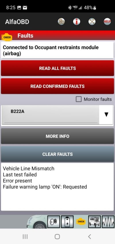

And...my airbag light is back on
This is what I'm trying to accomplish l, my wife's winter beater is a 2015 pursuit charger
As such, the rear door do not unlock when you open the front door because of a line "police lights" (YES/no)
The only change I made was switch over to "police lights" (yes/NO)
Now I get this code
I guess that means I need to change a line somewhere...but where ?
Now I get this code
You might actually have an airbag issue... IDK, but when it comes to Airbags, they are one of just two things I won't attempt to fix on my own (the other being mount/balance tires - more because I don't have the tools rather than not being able to). Since this was once a police vehicle, it is possible they disabled the airbags or that the airbags were deployed at some point - that makes everything suspect with regards to the airbag behavior. I'd take it to a good mechanic, or the dealer. Check on airbag recalls too - though I don't think dodge/ram was affected by the faulty airbag thing a few years ago, a lot of vehicles were!
The thing is, when I put it back on "police lights" the air bag warning goes away

Scan for codes. It's probably there in both modes. All you're doing is blackening the dash with Police Lights I believe.
What is the code?
If you have a code start a thread on it if you have questions so this thread doesn't get anymore off topic, and it will get the attention to repair the issue if you want the help.
What is the code?
B222a
I dont know why, but the code clears itself when I switch the "police lights" back on
Something in that package must tell the computer it has less airbags then a regular charger
So when I turn the police package off, the ORC starts looking for airbags that aren't there, or aren't hooked up (I think)
I have read that the line "vehicle line mismatch" sometimes shows up when you change the model of a car (might have been on here, I read someone installed larger fuel tanks and changed the code to a chassis cab to make the fuel tanks read, and he got the same issue)
BUT I can't find the issue
I did a status readout (or whatever it is called) before and after and couldn't find the issue there iether
