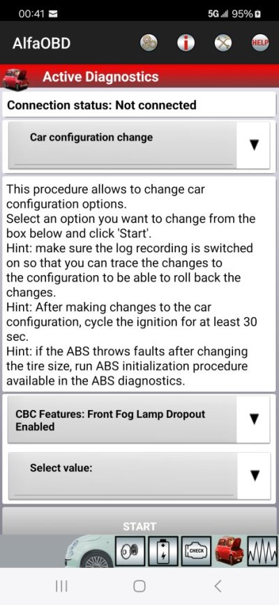

The setting is called fog light dropout. Set it to no and the fogs will stay on with high beam.
P.S. 18Crew - you beat me to it.:)

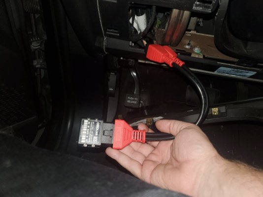

Did you figure this out?
Yes, it was the fog light drop out function, as others mentioned
The real issue I was having was that this is a 2018, so I needed a security gateway module bypass cable which NO ONE makes for a journey
So I took a change on something marketed as a 12+8 cable, and it works like a charm
