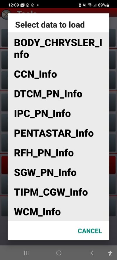

That doesn't work. Go into alphaobd, then email info log from within alpha. It will give you a list of logs to create and email. Pick Body Chrysler and email that. Should now open within outlook. I just tried it now and it works fine. Not even attached to the car, it just emails last one in history.

Well, I tried it on my Samsung S20 Andriod using their Email app and it opens in that fine too. You can then copy and paste it to a word document.
Also, if you pick upload to Google Drive and then upload the files you want to Google Drive they will open inside of that too.

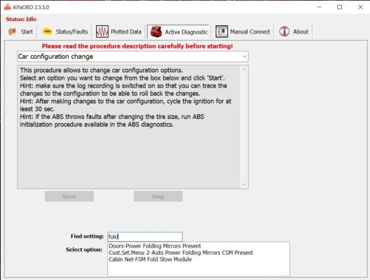

i have performed a search and unable to find my question. is there a command in alfa that will enable automatic folding power when ignition is on/off? i have looked and i can not seem to find anything.
thanks
If you're talking about the mirrors then I dont think so. I added power folding mirrors to mine and everything works perfectly, except no option to power fold when ignition is turned off. If someone knows a way I'd like to know too. Although I do not like to fold them constantly as it will wear the motor prematurely. I fold mine when I'm in a tighter parking spot and that's it. If you have a taper from z automotive it will perform the autofold,but you have to leave it plugged into your obd2 port. I have one,but like I said i worried about the motors wearing.
thanks
I haven't tested these settings yet but they look promising. It does appear that you may require a fold stow module (FSM) though.
More reading on this topic.
Brandon-w has an idea in post #10 that might work with the least amount of grief.
