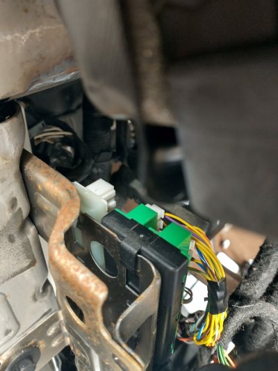

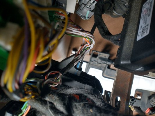

Actually I do have very large hands it's always been a trail to find gloves.
Also I ended up using a CAN bus that I could access after popping the dash side panel and the headlight switch panels out.
Much easier to see and access from the top
