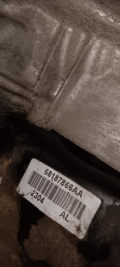

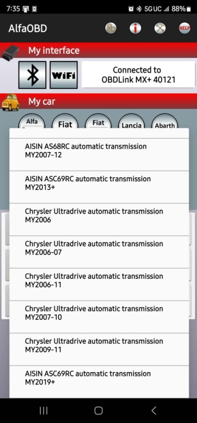

I have a 2015 ram 2500 with the 5.7 Hemi recently I swap my transmission and I just bought this transmission from a 2018 Ram 3500 both of them are two wheel drive I finally put in my new transmission to it it runs great but I noticed that sometime it will downshift hard and I'm kind of worried that if I don't get this taken care so I have the device but it seemed I can't find or I don't know where I need to go to find a setting to relearn the transmission so hopefully if you can help

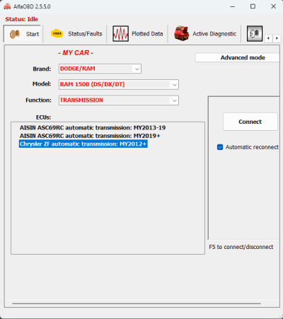

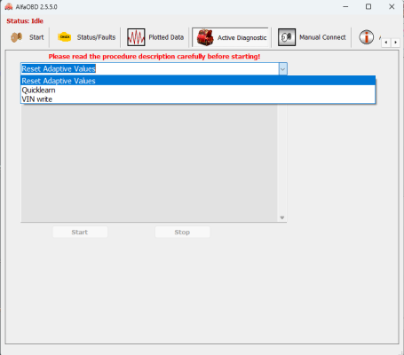

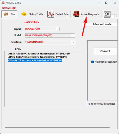

Try these steps. I am using windows version so will look different, but you should get the idea:
The AlfaOBD also have the VIN write feature for the transmissions, so don't forget that.
Me, not knowing exactly what you have, I am showing my '16 1500. I looked thru the 2500 and 3500 pages and this stuff is in there, too.
Select your truck model and xmission type:
Click on active diagnosis
Click on reset adaptive values: (This should be done prior to quick learn)
Go to quick learn and follow the directions
Hope this helps
Hope this helps

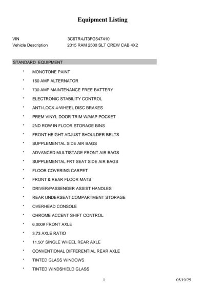

Thank you I'm going to go ahead and try that once I get off of work and I'll let you know if it doesn't work I might just say screw it then just go ahead and buy the window ver but you do need any more detail about my truck let me know

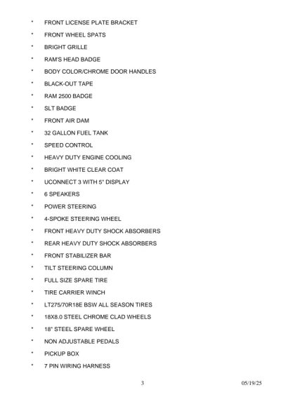

Hope this helps
I appreciate your help but none of them even working it keeps saying fail connected and I have reset it multiple time I probably just wait till I try to see if I can buy the window version cuz it ain't working on the Android
RamDiver
Jan 23, 2022
5,634
11,871
Marlborough, Ontario Canada
2021 DS
After selecting your brand, model, function and transmission, the next step is to connect, before clicking the open hood.
After a successful connection, then click the open hood for active diagnostic.
Is that the process you have been following?
I also use AlfaOBD for windoze but I believe the directions I've posted here are correct for the Android version.
Send Alexi (the AlfaOBD developer) a note and he will give you a code it enter when re-installing on a windows Pc, so you won't have to buy it again.
Me thinks it is an issue between the phone / tablet and the dongle. There may be a setting in the phone that is preventing connection,
Have you paired your Android device to the Bluetooth OBDII adapter?
No I think I need to purchase the window version of it I don't know if the issue with my phone communicating the dongle
