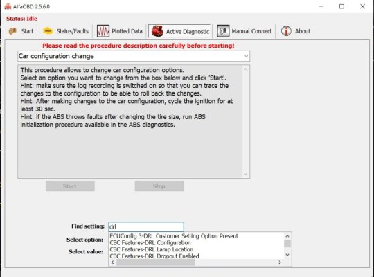

Sounds good. The two settings I am trying to get working on my 17' 3500 HO Laramie are FOGs with High's on (confirmed working) and DRL's as blinkers (Have projectors) this is very much not working. (links below).
Giving up on those for now; next big thing will be programing a new start/stop fob..... Thanks for checking in :)
https://docs.google.com/document/d/1cOPRgM7z957XJTg16NSjozfXNbrHdjkRQzCs2t0HYRc/edit?tab=t.0

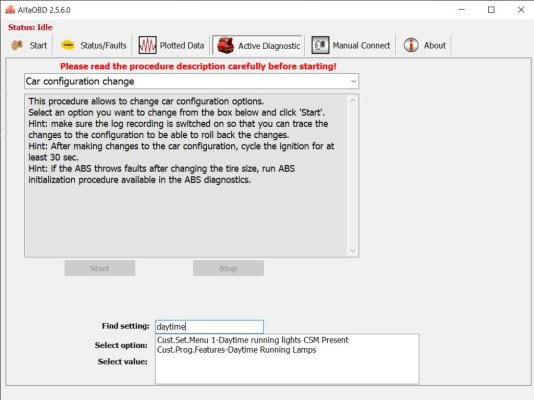

I have found that some tweaks have instantaneous results, such as the foglight dropout disabled, while others take several days or several ignition cycles, like the DRL changes.
I've found 6 different settings to tweak for the DRLs.
So, the "known working" settings for DRL, change and drive for a few days and see what happens? Is there a re-boot / re-init of the BCM needed maybe? Don't want to get to crazy in here. :)
I've had to reconfigure all the AlfaOBD tweaks at least 3 times or more due to warranty work where they reset the BCM settings, my oops last June and just experimentation, etc.
My experience with my '21 Warlock is that some are instantaneous and others seem to take days. I don't drive too much, maybe, that's part of it, IDK.
The DRL tweaks always seem to take several days for my truck. My last re-tweak for DRLs was the end of June, and it still took days to arrive, while everything else was immediate.
IDK if my truck being Canadian creates a delay, as being a Canadian truck and having an optional DRL is a legal conflict. :cool:
Did you review the 6 DRL items I've listed above?
Turns out.... You have to be in gear for them to turn on...... Must of missed that somewhere. Used to my Chevy being on with key...
So, settings from known working, work. Including the on / off in the user interface... Problem solved. Next challenge, gear display.....
