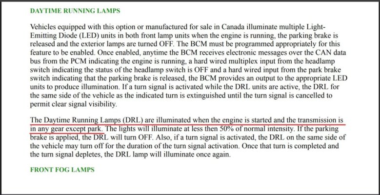

I would say, based on this excerpt from a 2013-2016 service manual, the only method to circumvent the transmission state from controlling the DRLs would be to use dedicated power.
It isn't stated directly, but it appears the PCM messages the BCM via the CAN bus network when the transmission is moved out of park. Then, when the other analog switch conditions are satisfied, the BCM will enable the DRLs.

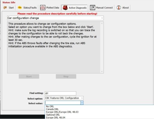

AFAIK, older Ram trucks built for Canada used low-powered high beams.
Sometime around +/- 2019, they started arriving with front turn signals as DRL, same as my '21 Warlock.
AlfaOBD gives you options for the DRL location.
You may need to switch the DRL configuration to the Optional DRL to select the different lamp locations, but I haven't tested this.
This is how I altered mine and added the CSM option to enable/disable the DRLs.
