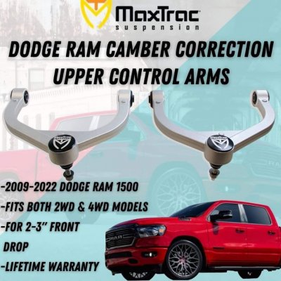

If you put in something like a bell tech 2/4. You might want these.
Even with these they indicate caster between 5.5 and 7 in their installation directions.
You only really need to worry about camber and toe.
My caster is 6.2 left and 6.0 right. With an IHC 4 inch drop.
honestly never seen those before. i may return the joints i ordered and buy those. with that much positive caster how does your truck track?

Like it's on rails. Very stable. I spent alot of time with the alignment guy. His comments were you need a little difference between the two caster numbers to account for the crown in the road.
It's really camber and toe that counts for alignment
I was looking at these however both MaxTrac and Summit say they are incompatible with my 2012 Ram Express 1500 2wd. I'm pretty sure Ram used the same arms for quite a few years so not sure why they say incompatible.

I have a set in my garage that I ran for about two weeks due to a self inflicted ball joint issue with my ihc uppers. Bolted up like factory. My truck is a 2014. No issues.

Are these numbers with new control arm? Do you have specs on keeping stock control arms? Did you have to cut your TOE rods?

I don't have spevs with stock arms. I did cut my tie rods, 3/8 inch on inner and outer.
