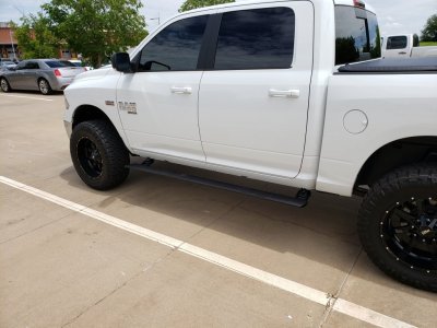

Can anyone post a pic of them in the out position so I can see the ground clearance to the running boards?

I say get them . I have them on my truck and love them, and I have a 6in lift. My wife has no issues getting in and she is 5'4.

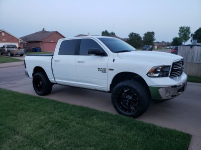

I think you will be very happy with your decision. I am currently lifted about 5" up front and 4" in the rear and my 5ft 2in pregnant wife REALLY appreciates the AMP running boards. The only issue I have had so far is the plug on one of the motors worked itself loose on a long road trip and stopped working until I pulled it off, cleaned it, and plugged it back in.

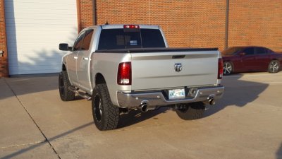

Good choice with the AMP running boards. I have them on my 2500 with a 5 inch lift and 35’s. My wife can easily stand on them to strap our 8 month old in the car seat with no issues.

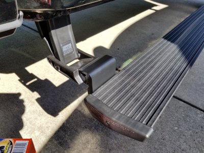

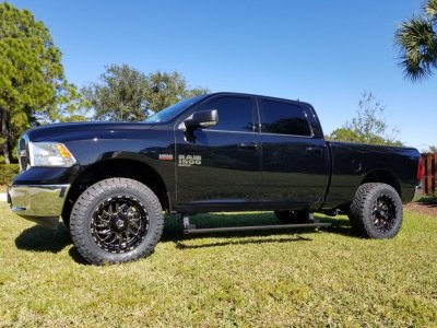

Update on the Amp Running boards
The height was 15" from the ground to the top of running boards before the 2" extensions
Well the 2" extensions dont fit the model numbers of my running boards
So I figured out why.

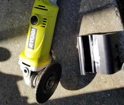

The extensions have the middle part higher and slotted on the ends
I had to grind down the middle part on all 4 extensions but it worked !
Now to the top of the running boards is 13" , same as stock height before the lift and tires !
