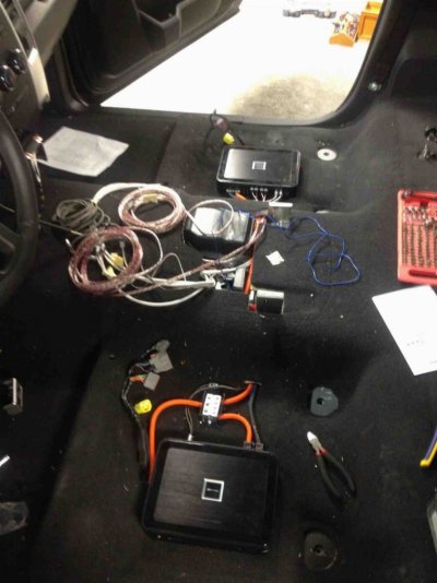

Cmiller that looks great. You didnt half ass that at all. I wish i had the time to take it all apart like that. Kids always keep me busy.

Thanks! My seat is power as well there is really alot room under it. It all looks like a mess in those pics but I had a lot of wires to run. I even made a wire harness that plugs into the factory harness so there are no spliced joints, if I ever want to take it out all I have to do is unplug it. The white wires you see in the pics are actually home audio wires that house 4 wires inside it worked great for the install to keep it all nice and neat. Here is the box I built for it.

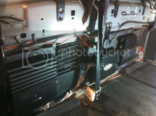

Back wall, rectangle with 2 square cut-outs for vents, 3/4" mdf, routered, painted, screwed to wall, amps screwed to board, done. Make amp adjustments before rear seats go back in lol
Arc amp has internal cooling, but the 2 Alpines never ran hot and were drivin HARD
Mine looks a bit different now cause the 2 Alpines are gone but you get the idea.
Plus it would be a pain in the butt to steal!

nice setup autokraftgt. I have the same amp. It's tight quarters i the truck, but i want to be able to access it. I only have one amp...so i'm thinking under the driver seat. But i won't have alot of room to wire. I would really hate to remove my driver seat.
