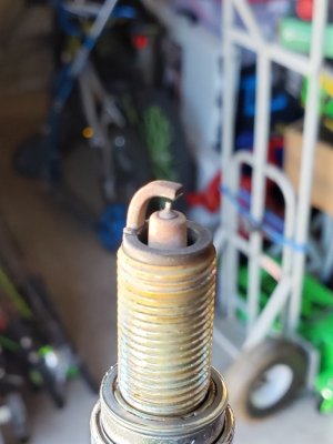

Figured after I did the plugs and belt I’d do a throttle body service too

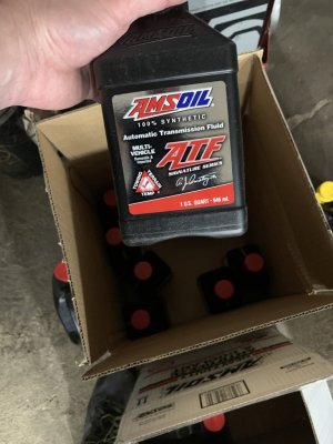

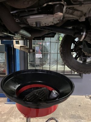

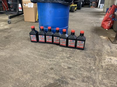

Took just over 7 quarts. I let it all drain out. So now I will let it cool and check the cold level now that I checked the hot level. I drained it for about 3 hours. Just about 7.2 quarts to fill to perfection while trans temp was 180

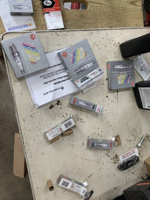

Changing the spark plugs was 100% the hardest part of the entire job. Power steering fluid change was the second, transmission and coolant were tied for 3rd the brake fluid was satisfying to see all the Sediment flush out.
