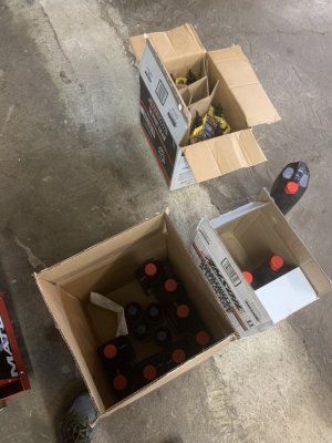

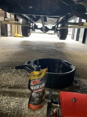

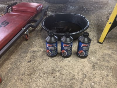

As my truck approaches the 60k mile mark I decided that ALL my fluids should be changed.
Since I am an Amsoil dealer I will practice what I preach. The only fluid that will not be Amsoil is the transfer case. I got that from the dealer along with the filters for the transmission.
5BC31AA2-B04B-4618-84C7-17C9C6424A52.jpeg 057B852A-7027-4D6D-BF79-1A16BB147CE2.jpeg 865BB699-7AEF-4C36-A46D-A7A2BF7439E5.jpeg

To do:
Brake fluid
Spark plugs
Transfer case fluid
Front and rear diff fluid
Power steering fluid
Coolant
Transmission fluid and filters
Serpentine belt

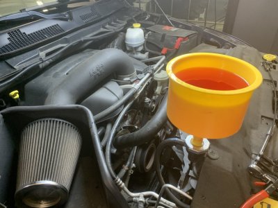

Where did you get that sweet funnel on the radiator?
2018 Ram 2500 6.4L 4x4
Amsoil SS 0W-40
I actually bought that to bleed the cooling system in my 2002 Ram because it was a sealed system. Highly recommended kit it’s been used so many times

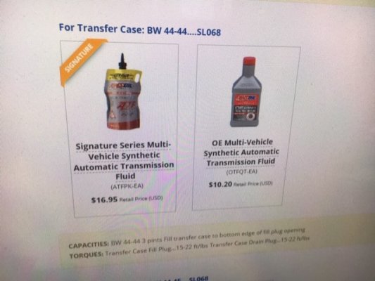

Is there something that you’re saying indirectly about their red cap signature series ATF that’s recommended for all 2009+ 1500 transfer cases?

Is there something that you’re saying indirectly about their red cap signature series ATF that’s recommended for all 2009+ 1500 transfer cases including your NV243?
No couple reasons I went to the deal. 1 was I was getting the trans filters from them and 2 I had them look it up by vin since my truck is a 12 it’s that odd year so I was not 100% what trans and transfer case I had. I did not see anywhere on Amsoils website that stated Meets or exceeds bw-44 on my quick search that I did
You're a dealer? This say's 44-44.
yeah I wasn’t sure what transfer case I had so I got fluid from the dealer. I may have done a more in depth search if I wasn’t going to the dealer to get the transmission filters.
I've ran the MVATF in my 44-44 and it worked fine. I've also ran Redline C+ in it as well. No issues whatsoever in all the modes from not using the dealer fluid.
The dealer 44-44 fluid is a money maker for them. They originally had speced ATF+4 for everything but the 44-44 but then they all of a sudden changed it to "transfer case fluid" for all their Tcases. Same part number but all of a sudden it covers all the Tcases? Right[emoji106][emoji106][emoji106]735280904ae949fb9fae365751854bff.jpg
For 2016- it's supposed to be 68049954AC, but if Amsoil says theirs will work, I believe them.
