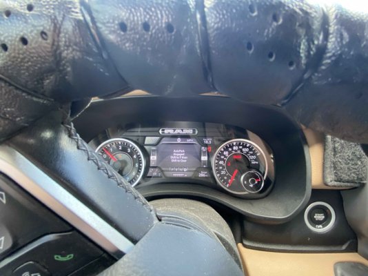

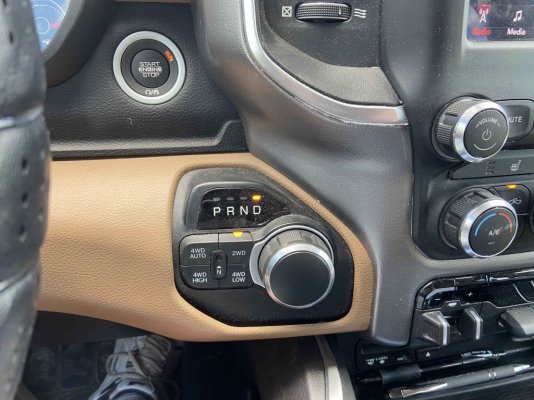

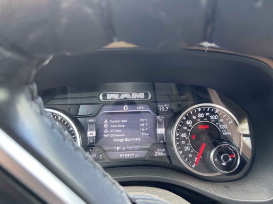

Emergency brake engaged over rode the safety feature, that comes under safe hold. I have done it once, thought in drive, got out, vehicle started to move (my difference as E brake not on and vehicle started to move, where yours had the E brake on not moving), and locked up. It is a good safety feature but can also be a monster PITA. All IMHO...
ADDED: OK, went out to MY 19. Truck in park, set E brake, put in drive, open door, "get" alarm, shift into park. The "D" light flashes on the dial knob but does not go to "P", but the system does go to autopark. Does the same thing if I open door when in gear and move forward (safehold).

Do you have the ZF Transmission (dial) or one with a column shifter? The problem is with the dial shifters, where either the user thinks they are in P, when they actually only turned it to R, or the computer that shifts the mechanical selector somehow doesn't make it all the way to P before the user gets out.
If you have a mechanical (column shifter) this isn't an FCA problem that they have to fix if you forget to put it in P...
I have the ZF 8 Speed with the dial shifter on the dash and the 2WD, 4Hi and 4Low buttons next to it. Im going to experiment with this nex time I'm in the truck to see if I can figure out what its really doing. This is always something I've done by accident so maybe I don't have the exact sequence of events down. Could the fact that I have the parking brake engaged play into it?
"E-Brake"??? I see you have a 1500. Mine is a 2500 and its not an E-Brake (far as I know??). Its an old fashioned pedal you press down with your left foot and have to reach down with your hand to pull a lever that releases the brake. Or is my pedal actually an E-Brake in disguise?
