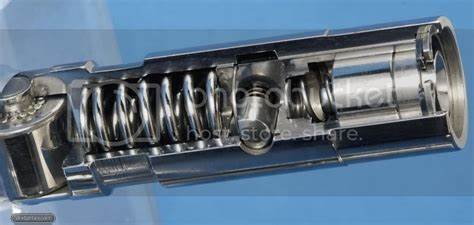

top one mds lifter, bottom one non mds lifter. 12-15 minute mark this video... 16.45 mark he explains the lifter posted above.

His theory, if we could be in mds mode 24/7, there would me no lifter failure, note the beginning of the video for his credentials. Even if we have non mds lifters, tune mds on to operate all the time = no more cam fails? to be honest, above my pay grade stuff there, but it makes sense to me.
Not sure what you’re referencing in the video.
When the mds solenoid are installed they block an otherwise open passageway in the block and act like a valve opening and closing that passageway to the lifter galley.
With the mds block off plugs are installed, that passageway isn’t block and oil is always free to flow.
So doing the mds delete plugs with non mds lifters, you have an open flowing passageway leading to lifters without mds resulting in increased lubrication vs an mds engine.

in mds mode the oil is pressurized which is the difference. Putting pressurized oil right in the lifter bore, much different then oil pressure from on oil pump. Obviously both mds or non mds have cam fails and this is just a theory.
