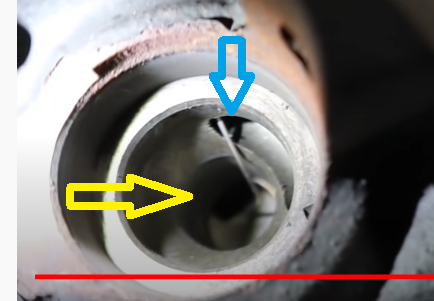

Not sure what you're asking here as the camshaft lobe and bottom of lifter wheel sit out in the open basically in the crankcase,they aren't enclosed by the block or the heads. The cam journals are part of the block,but not the cam lobes or bottom of the lifter.If you have the cam and lifters out,you can look through the bottom of the block right to the bottom of the heads by looking through the lifter holes.
Yeah I understand that. I was trying to understand where the main oil galley's were in the short block.
I saw a bunch of different car forums agree with your assessment; oil flows up through the pushrods as a function of lifter piddle! :waytogo: Thanks for bearing with me while I researched / asked more questions.
For anyone else reading, this video helped me understand the MDS and main oil galley systems better. Understanding MDS and Lifter Oiling
He came to a great conclusion about switching cams and lifters to non mds but then keeping the MDS solenoid and tuning to have MDS solenoids open all the time to have better oiling to all lifters. Seems VERY intriguing -

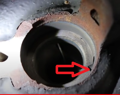

I think his conclusion is to use the factory block off plugs,if you watch till the very end.It's my understanding the plugs accomplish virtually the same thing as having the mds engaged full time. I've been running Stanke's billet mds plugs for several years,but if i was doing it again,i'd go for the cheaper factory plastic block off plugs,as the stanke's are gold plated in comparision,lol
Edit**
Preface - I realize this dive into understanding lifter oiling still doesn't address the fact that 90% of engines don't have lifter failures.
Just re-watched the video (to the very end :emotions34:) and I agree with you that the block off plates still allow oil flow between the bottom galley (yellow arrow) to the upper galley (blue arrow) as they are the same depth / diameter as the black portion of the mds solenoid, and has the same 2 o-rings.

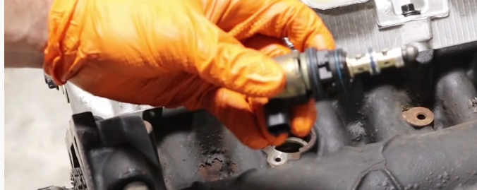

Do you guys know where this upper most hole leads to and does the solenoid allow oil flow there when activated (out through the side of the black section)? The plug looks like it may block this orifice?
View attachment 501141View attachment 501142
I think it's a bypass hole to allow excessive pressure to bleed off when mds is engaged,but don't quote me on that one though.
