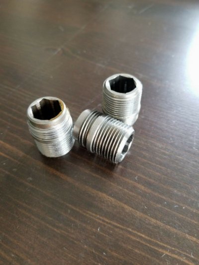

RFE filter option thread. any rfe all you need is the metal thread upgrade, i recommend the hex threaded one they fit tighter. You can use old filter or any filter to knock the paint of the synthetic filter you are installing, like pictured by smoothee. Hold on to other filter then knock off the paint with whatever. ebay seams to be best source of screws. round billet ones are loose, these are tight.
Appreciate that.

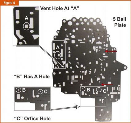

You need to find out how many checkballs you have in your VB and that can be done with looking at the solenoid pack connector. If it’s white, you have 7, if it’s gray, which most if not all 65s are, you have 5. If you run the incorrect amount of checkballs in your vb, for instance using 7 check balls in a 5 check ball valve body with a 5 check ball separator plate, you will get pressure codes with a limp-in situation. Wont do any major damage, but the vehicle won’t be able to be driven.
Looking for an emoji that shows my mind blown by what you said. Maybe itll make more sense when i get down there. I was under the impression if you had grey then you have to upgrade to white. Then again im only just learning so maybe i misunderstood something. Appreciate the help.
Thank you, and the gray and white solenoids are pretty much the exact same. The White solenoid pack was pre MY2012, when RAMs had the option in the 3rd gen trucks for 1-2 manual select with the column shifter and before they made it to where the OD solenoid in the valve body was the one that pressured up the OD clutch and it the Multi-Select clutch.
The gray SP eliminated both of these as they weren’t needed anymore. Learning is good!
You can interchange a 5 check ball valve body (gray solenoid pack connector with 5 check ball designed separator plate, seen in image below) with a 7 check ball valve body with white SP and you’ll have no issues. d19edb7136ee1437aa534a3be9d747ef.jpg
7 check ball separator plate:
Hope this helps out people in the future who need it, and if you need more help in the future, send me a PM!
