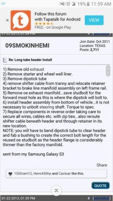

Can someone please tell me how to do my transmission cable reroute my headers came with relocation brackett but i dont know the best way to route or even how the bracket goes.

I found this but still dont were to but bracket.
I realize this thread is a bit old but I have this question and it didn't seem to get answered here lol. ARH sent a bracket and a picture, but the black and white photo showing where it goes is worthless. I might just zip tie but would like to use this bracket.

I think some people zip tie it, but there is a bolt that needs to be removed to put the bracket on. It's easiest to turn the picture with the way you are looking at everything with your head in the wheel well. It re-routes it nice and close to the firewall and up.
I did mine in september and it's hard for me to remember exactly which bolt, but once you start pin pointing other points on the picture it should lead you to the bolt and it will make sense.
