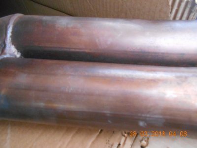

Wrapping them keeps more heat in the primaries which promotes better exhaust scavenging ,leading to a better cylinder fill on the intake stroke ,consequently more power,plus you'll have way less issues with under hood heat trying to burn up any hoses or wiring in the vicinity of the headers,and the biggest gain is you'll keep the knock sensors way happier,they sit right under the primaries and have a tendenancy to pick up the internal pinging in the primaries. Anybody who tells you ceramic coating is as good,is full of ****,see which set you can put your hand on the longest before frying your skin,that'll tell you right there which way keeps more heat in the primaries,lol. My JBA's have been doubled wrapped since the day they went on 6 years ago,and my truck is nitrous fed so it generates more exhaust heat then most trucks,and they're still in great shape.My complete exhaust is wrapped right back to my X pipe,as i use the mufflers as a poor mans expansion chamber. This is what my cheap JBA midpipe looked like after being wrapped for 5 years,doesn't even show much in the way of surface rust or stress cracking at the welds,and JBA's are supposed to be junk according to some guys on here,lol.
