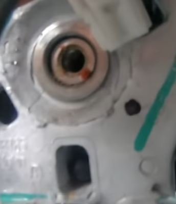

The connection between the steering shaft and steering wheel has splines a half inch long to keep them moving as one. With the air bag off and the nut removed you can verify the the two parts are mated and turning together. In this pic you can see the steering column with the red marks visible with the steering wheel retention nut removed.
Unless your steering wheel is almost completely off or the splines have been stripped your issue would need to be in the steering column or below. Not sure how that would be damaged, even if you did not use a steering wheel puller.
