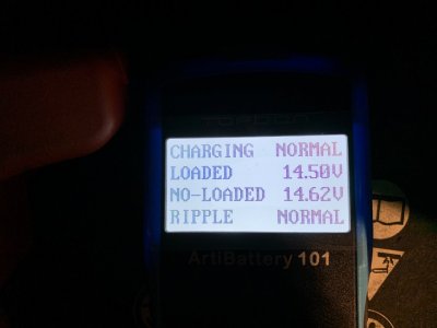

So my 18 Laramie CC I got back in Dec 2018 has hit 21k and it’s 2 years old. Within 3 months of having the car I forgot to turn off a dash cam when I went on vacation ( I have one that’s on when the truck is on and another I can leave on when the truck is off) basically it ran the battery dead (9v) I was able to hit it with 50amp charger to jump it and brought it back but this was over a year ago. Fast forward to tonight... I got a cool new gadget (Topdon AB101) that runs diagnostics on your battery, charging and starter essentially. I’ve used it on other batteries and testing my systems. Tonight I decided to test my trucks battery and just see how it’s doing (it hasn’t been giving me any problems) and I’m kinda shocked my the results.
see the attached photos. Basically it’s saying to replace the battery, SOH (state of health) is like 45%. SOC (state of charge) and my CCA should be 730 but it’s showing 520amps. Then my voltage drop during cranking/starting is at 9.56v and the internal resistance is at 6mega ohms.
like I said I haven’t had any problems with it but alittle shocked on what it’s showing. Any of you guys had any factory batteries give up the ghost before 3yrs?

I'm not terribly surprised. You did run it completely dead, which is really bad news for a Lead Acid battery.

If you bought it in Dec 18 then it is actually only a little over 1 year old. Any 12v lead acid battery you allow to drop below 9 volts has been permanently damaged. Generally they will tolerate it once or twice, but also you should have trickle charged it back up for the least amount of damage rather than jam 50 amps into it. I'd say the battery analyzer is correct and it has some damage that gives it a lower storage capacity. It will probably be fine for a while as long as your charging system works and your truck starts quickly, but it will most likely fail quicker than normal if you put it under the stress of long cranking or leaving lights (or dashcam) on for extended times.

I'd check it with a legit battery load tester before buying a new battery,as your truck shouldn't start at 9.56 volts,which makes you wonder how accurate your gadget is.
Wait i get it, its the drop hes measuring, 10.5 is tolerable. Thats the voltage WHILE cranking, 9.5 is low but will still crank.
If you measure 9.5 BEFORE you try to crank, it probably will not crank.

Think he meant, he checked battery it was 9v then he connected 50amp charger, that allowed him to start it.
I think he says it drops to 9.56 while cranking OCD,and if that's the case the truck shouldn't start,or at least not very good,lol.
