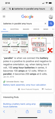

I’m playing with dual power sport lithium batteries at the moment. Going to try to run them in my summer car and see how they work out. 380CCA each and 21 Ah each, so 760CCA and 42Ah is more than the OEM ram battery I believe. Cheap little ******** too at $54 each. So $150 all in including the adapters. So about the same price as a decent gold lead acid battery around here but $50
Cheaper than an AGM. Lithium should last min 5years but usually around 10 if taken care of.

Plumbed in parrallel will double up the CC amps,but won't double your amp hours,you'll still only have 21AH's

Pretty sure in parallel doubles amps and capacity but voltage stays the same. In series the voltage is doubled but the amp hours remains the same.

It’s all good. It gets confusing after a while especially adding 4 + batteries
Peukerts Law might interest you. The amp hours only double if the load stays the same,if you double the amp draw load the amp hours do decrease.So the idea of doubling up your batteries to increase amp hours works as long as you don't double the load at the same time.If the starter draws more then the first batteries amp hour capacity,then you won't have double the amp hours as you're past the first batteries capacity.Whether one of your batteries will start the vehicle at 32F is questionable,and if it won't then you won't have double the amp hours by hooking another identical battery into the circuit in parrallel. The scenario observed here is assuming one battery will supply 380CCA at 21AH and will start the vehicle,but if the load is more then that battery can handle (ie:starter clicks,or doesn't turn the engine over fast enough to start) throwing another identical battery into the mix will not double the amp hours to 42. The case your looking at assumes one battery is adequate,but i'm not sure one 380CCA battery will start the average vehicle at 32F.
http://all-about-lead-acid-batterie...amentals/peukerts-law-and-exponent-explained/
