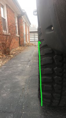

That’s the most likely culprit.
Are the front tires wearing evenly? Especially the right tire.
If it has any odd wear on it then yes replace both upper and lower A arms.
Depending on how many miles are on the truck I recommend changing both sides and also be sure to get the arms with serviceable ball joints.

The passenger tire camber is definitely off 100 percent and it is tilted in for a slightly negative camber. I have pic but its not the best haha
