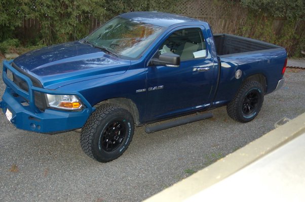

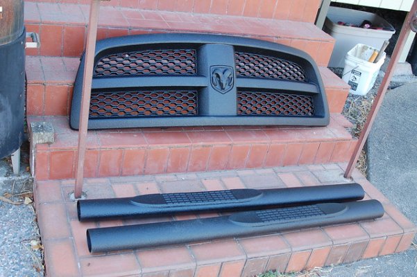

line'x charged me 50 dollars a piece to linex ratty parts, the grill has held up like new for years. The tubes have held up as well, but a little more faded with time.
I did something similar with Rust-oleum bedliner on my wheels and steps. I've found that the foaming tire shine cleans it up nicely.

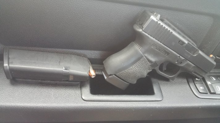

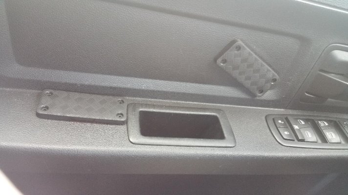

I carry a Glock 30 in a small-of-the-back holster. It has chewed holes in every shirt I wear due to the steel belt clip. I decided to buy some 55 lb magnets for $18.@ and Roscoe now rides on the door with a spare 13 rd mag from my G21's. 55 lb. magnets are serious as hell. Short of a high speed wreck, they do not move. Just gotta remember to grab Roscoe and put him back in his leather house before flinging the door open at Krogers, lol.7d80f561b45c655fd308b49e8e277ac3.jpg48a525e91d33bcd6ff0bf92482b85ade.jpg

Matches the color of interior quite nicely !

I did the same thing (in a different spot) but you get the firearm close and man, that baby snaps right onto it. Gotta keep your fingers out of the way or they get pinched lol. The double sided tape was pretty worthless, for me anyway. The first time I pulled the gun off the magnet, the magnet came with it. I had to use the screw-n-glue method....

Yes sir. 4 screws in each magnet. Learned my lesson re: neodinium magnets when I laughed about the WARNING! label and what I thought was a silly amount of material separating them years ago. hahaha.....SNAP!.....OWWWWWW! Dammit! Then the "Wife Laugh" and reminder all day long. "Oh, my big, toughguy husband got his wittle finger bit by a wittle baby magnet". I then did it AGAIN! She was rolling. All day. She's lucky I like her.
Back on track here, these worked out so well, I am ordering more. I came up with like 8 different places I want them, lol.
They work best on Glocks and steel 1911's.

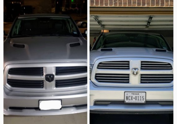

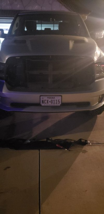

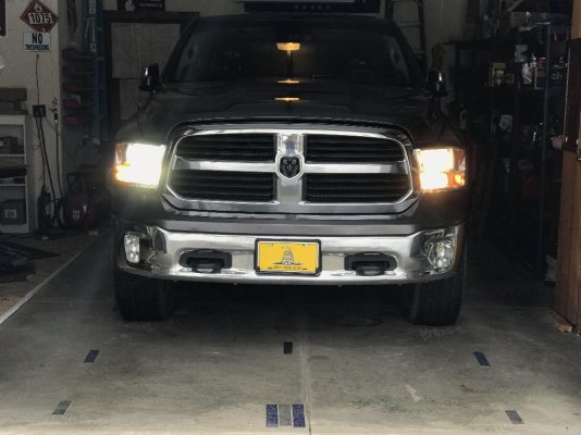

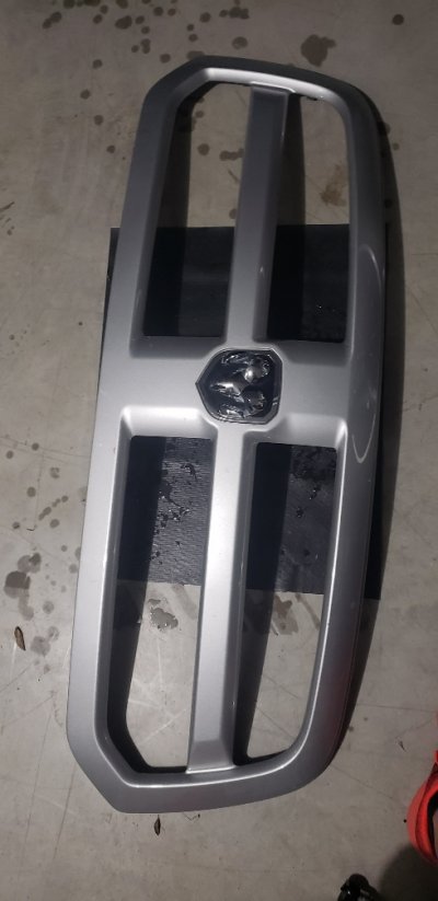

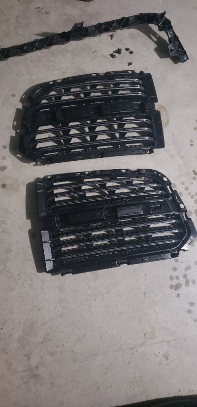

Plasidip my chrome grill inserts. Changed the whole look of the front.0e15a3b27aff7647836eeba038747fe4.jpg7fd9cf2a1384360ee8c0672906dffc30.jpg80d1db05615d0b12a010c49d2a0ff04a.jpg22ca43165cd09605f7f8274dad5db137.jpg
Much more Ramy!

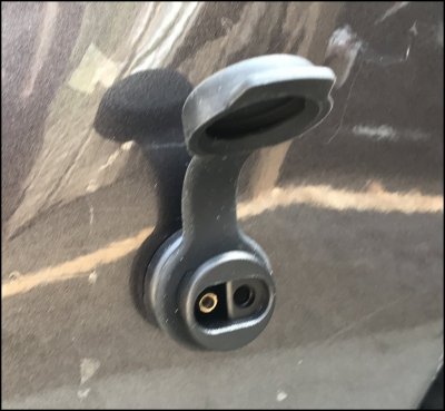

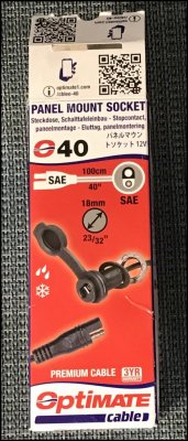

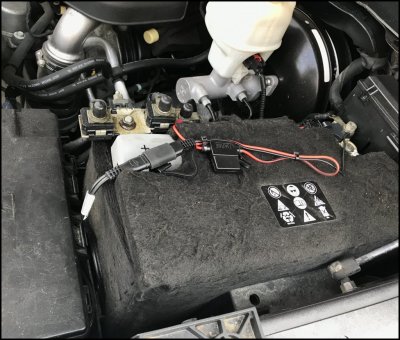

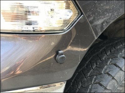

I keep my ED on a trickle-charger in my shop. I got tired of popping the hood to hook up, and I don't like searching around for a dangling cable end.
I bought an Optimate 40" panel mount socket for $16.56
https://www.ebay.com/itm/OptiMATE-C...133980&hash=item420800c505:g:1T0AAOSwJmJe6A9m
After numerous re-measurements (really hard to just punch holes in the bumper fascia) I drilled out a 3/4" hole, mounted the socket and fished it up to the battery. Now all I have to do is back it in and plug the charger in.
