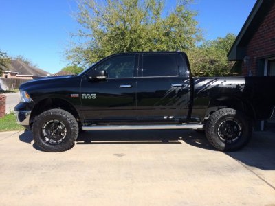

Not trying to steal a thread but I don't know much about level spacers or the 5100s.
I would like to get the 5100s, as everyone speaks highly of them.

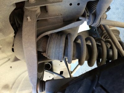

I'll post a pic of my truck and a picture of the front level that the dealer had installed.
Will I benefit from the 5100s? Moreover, will the 5100s work with my Pro Comp 6" lift? I love the rake and I don't want it completely leveled but would like a better ride quality?

Here's the pic of the level it has now. Not sure what it is but I think it looks nasty.

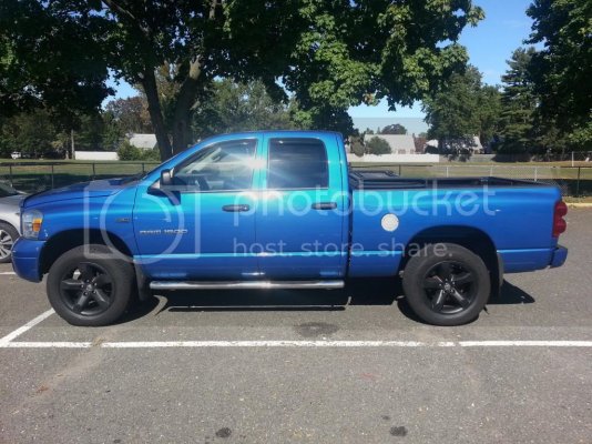

Hopefully Burla doesn't mind me tossing another blue truck in to the ring. But here is mine with the 5100s sitting 2nd down from the top.
Might be a slight rake, never truly measured front/back so cannot say with any certainty but does help the ride.

RAMWarrior1, how does it drive? Is it harsh over country roads and pot holes? 5100's will make your ride bouncier and your truck will have much more travel. Your setup looks weird to me too, some type of extension. Definitely not what you would consider an upgraded quality lift IMO.
The truck looks great though.
I completely agree, I don't like it and up close it definitely doesn't look like top quality. To some degree I notice the truck is rough on country roads and bumps. My wife actually notices it a lot more, but that's how I figured the truck should feel? Guess I was wrong from the sounds of how yours is riding now.
