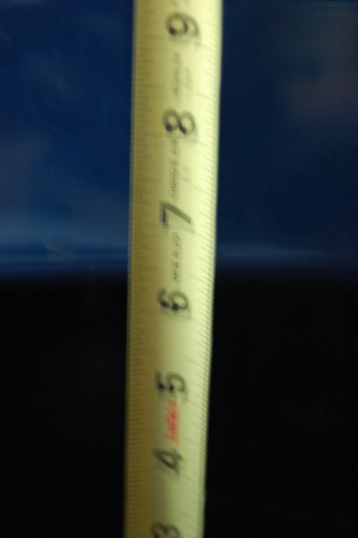

Be Prepared to be F'n blown away with a customer service story....
So Les Shuab first set the truck 2 levels down just to get a visual on it, he said it was way too low, so they took the shocks off again and set it one level down. Replaced the axle with a killer axle shaft better then the ones that come rusty from the factory, and realigned it, for free. Dudes, this is not the first time les Shuab in Rhonert park has giving me great service. I had to have some radius arm bushings and I called everyone in 3 towns, and was priced between $450 and believe it or not $1600. Shuab did it with poly lifetime bushings for $167. These guys are for real, so shot out to them for great work and fixing it with no questions asked and an apology no less.
OK, so I have been beating my truck all afternoon testing all of this stuff. With the new level just a 1/2 inch down, the vibration when in 4wd is gone! Gunned it around 50 times in 4wd and couldn't get but one faint hint one time of a vibration. So I can't say enough I recommend like so many others just go one step down. As you can see on the tape (sorry for the blurr) but it is only 1/2 inch or so lower then top level. I will take a picture of the truck when I get around to it, but it absolutely looks just as level as it did on the other setting. You would really have to look hard to see any hint it is not level.
The truck didn't drive noticeably different by changing the level, but of course it didn't have the vibration. I will drive for a while like 6 months and report back. But so far this is an amazing level and consider have Les Shuab do yours, they stand behind their stuff. I feel bad because this must have been a total loss for them replacing my axle shaft, but they have my loyalty and will be getting my tires/wheels from them as soon as I upgrade.

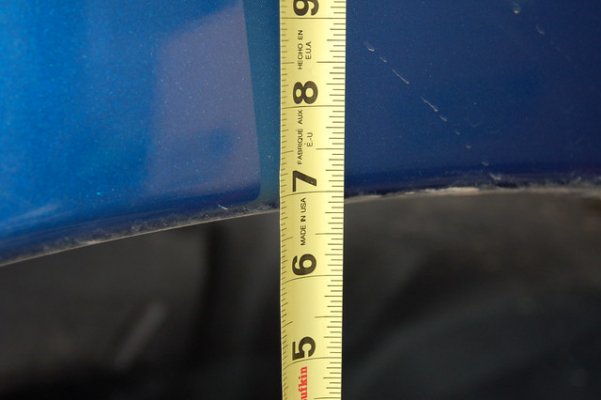

I don't know if I put it in this thread, but here was the measurement on the highest level of the 5100's and stock tires. Compare this to the pic above, it is only 1/2 difference but with no vibrations. So unless you are going huge with tires, just opt for 1 level down!
Post # 16 had the measurements, add the latest measurement and the 5100's are about 1/2 lower then the back on highest setting, and one inch lower with the setting on second setting- but this is for a truck with a heavy front bumper, I imagine that adds at least 1/2 of drop. have your wife sit on your truck is she is around 150 pounds or so, and that is what I'm carrying around.Absent a 200 plus pound bumper, and I wouldn't be surprised if it was exactly level.

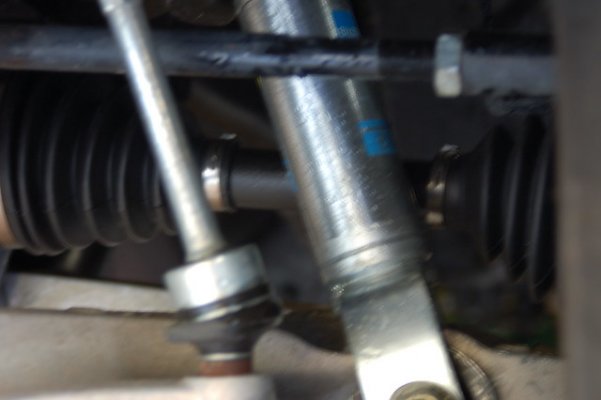

I found an EASY way to tighten the upper shock nut.
Put a 22mm socket in a pair of vice grips and clamp the socket tight. Put the socket over the upper shock nut. Insert a 6mm allen wrench into the top hole of the Bilstein. Use both tools together to tighten the nut.
You can even do this with everything already mounted inside the truck. You'll know when you get it tight enough because the allen wrench will get difficult to turn.
SO....if you have a little knocking noise in the front after your Bilstein install....give this a shot.
