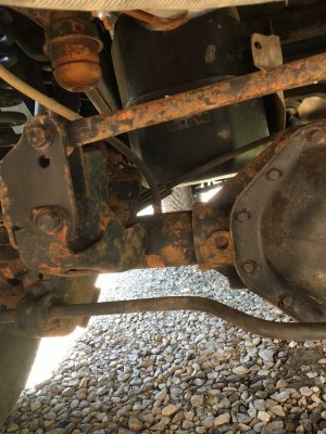

Not to rain on your parade but I would go over that truck with a fine tooth comb. It was probably run hard and put up wet. Also being from Michigan I would be on the lookout for rust. Crawl under there and make sure they didn't try and paint over and hide any (common tactic on vehicles from that area).
