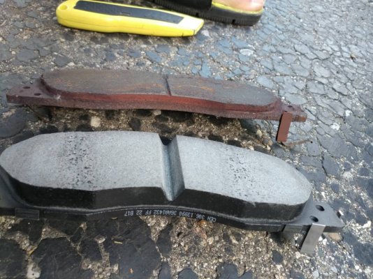

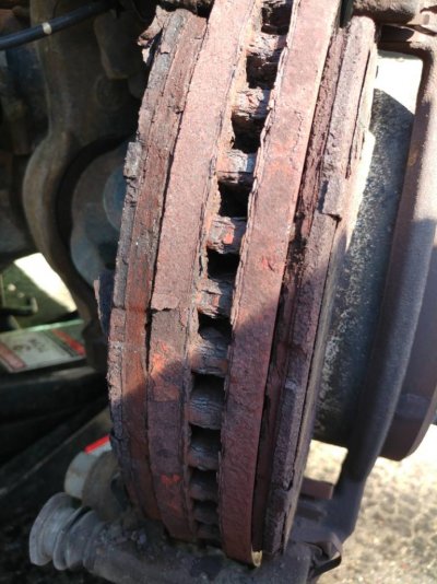

On a related note I doubt this is a problem for you but I've been noticing a lot of brake dust on my right front wheel the last few months, I just got around to checking it out and turns out the brake caliper was seized. The caliper itself was fine but the pins had frozen. I didn't notice a lack of braking but it definitely wasn't working correctly. 790d1ba87255a8060d91a1fadb473030.jpg066dfa521adbd796c941d902de764cc5.jpgb81c6f6207f39dde94211a8e7c651fd7.jpg
