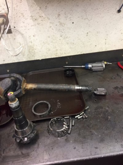

Absolutely ,however I don’t believe that happened, the terrain I was on was quite greasy all around and I was careful when switching directions.I will post pictures of the broken shaft when I can.
There it is boys and girls
Thanks. Looks like the fuse (OD reduction outboard of the sealing surface) didn’t work too well, if that’s what it is. Or the shaft was defective.
Yep that’s the general consensus just bad luck I guess and draw elk starts on Monday sure could have used my truck next week
