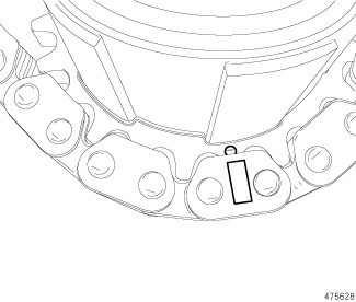

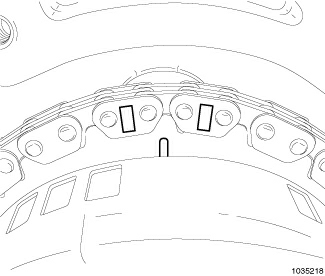

Do you have the timing marks in their correct location?
The two timing marks on the chain go to the 12 o'clock position on the cam phaser and the single timing mark goes to the 6 o'clock position.
Cam Phaser...
Crank Gear...
