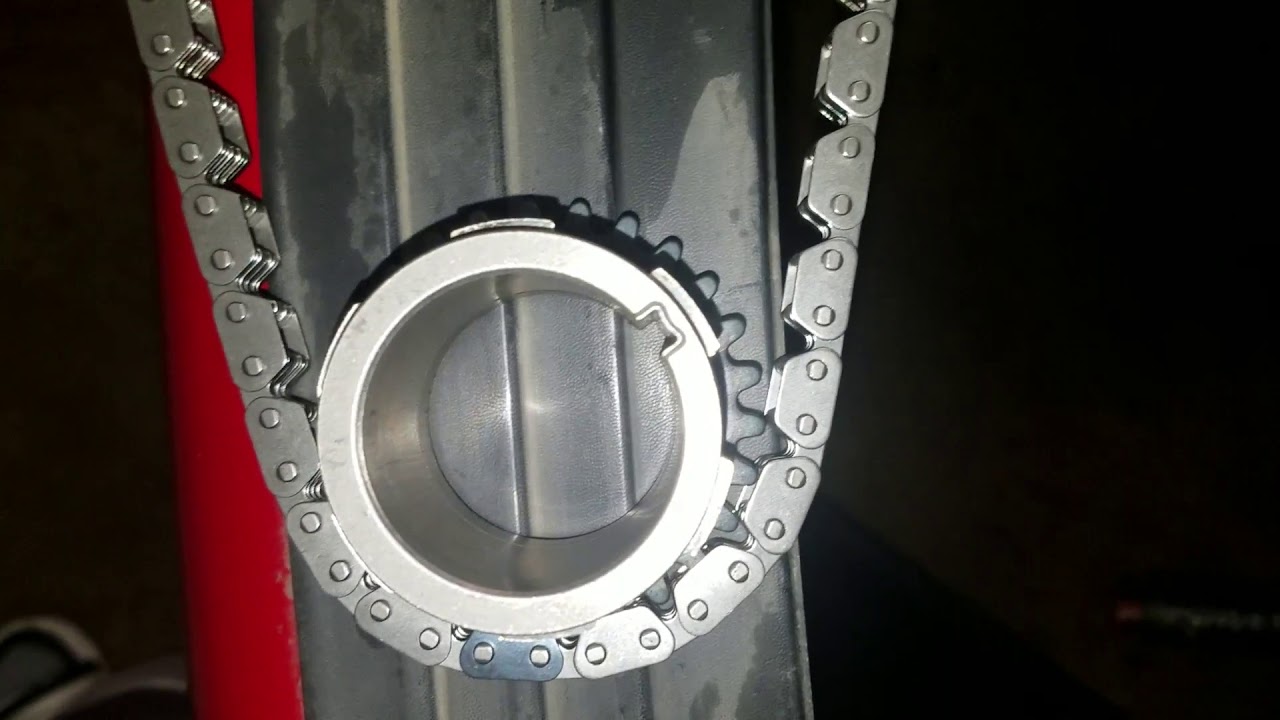

It is getting gas but all the codes came up. Number 1 piston at tdc, cam phaser at 12 o'clock and crankshaft gear at 6. It acted like it would try and crank. I don't see anything that I might have not plugged back up. Thanks for any help

Sounds like it could be out of time still. The positions of your cam and crankshaft sound right. Where there any marks on the timing chain? Did you take the oil pump out and verify that the timing marks were correct?
I used this guys method to get my timing right, I used the marking on the chain and the gear to get my correct timing.
