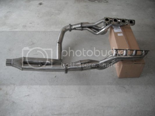

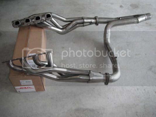

We received the only 5 that they built yesterday. They said it would be about 1-2 months before they have any more ready for us. The Y-pipe will be $259 shipped.
I have not put these on the site yet because 3 of the 5 are already sold, and I don't want people placing order and waiting when we wont have more for another month or so.
The Y-pipe looks really nice for the money. I know they will fit the 5 and 6 speed 09-14 trucks, but we are test fitting 1 on an 8 speed this weekend.

Yes it does. All the longtube setups on the market right now run the y-pipe under the transmission pan.

JBA's will only be offered without cats for the time being. They have not mentioned anything to us about offering them with cats.

No room to weld cats into the JBA Y-pipe, but you should be able to put them in between the JBA Y and the header collector. Just weld 3 bolt flanges onto both sides of the cats, and they would bolt right in place. I have not confirmed fitment like this yet, but looking under my own truck, I think it would clear. I would like to test fit this before guaranteeing it fits though.
Otherwise, like mentioned, Sean can disable your rear o2 sensors if running without cats. Even high flow cats will trigger a CEL for the rear o2 sensors, so Sean always disables the rear o2's when running longtubes.
