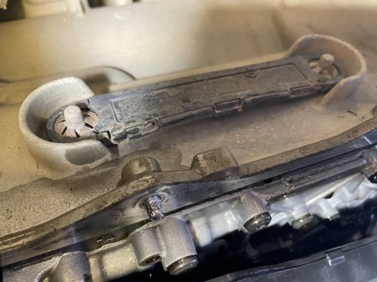

DUN DUN DUNNN.... when torquing to the indicated 89 inch lbs, one of the new bolts broke off in the trans. Full "oh ****" moment. Luckily there was *just* enough thread sticking out to get vice grips on it and after a careful application of PB Blaster and some work with the vice grips, it came out just fine. This pic was obviously taken after taking the vice grips to it. Had to remove all of the bolts, the pan, etc. Ended up taking way longer than necessary due to the broken bolt.
A few of the new bolts felt very tight going in- borderline uncomfortably so- but not stripped. All of the bolt holes were clean and free of dirt/debris. I decided to trust the process with the new bolts and low and behold, one did break. After removing them all I did end up reusing the original bolts and they all went in clean and free. Given they have such low torque on them, I don't have concern reusing them.
I caution you to be hyper aware if using new bolts if they don't go in smoothly- don't use them. This could have wrecked my whole afternoon :cool:.

Something doesn't sound right, no way you can break that bolt with 89 INCH pounds, that's only 7.4 FOOT pounds on a bolt rated 10x higher than that. You extra sure your torque wrench is INCH pound and not FOOT pound?
You can if the replacement bolt threads aren’t machined finely enough to match the threads in the trans. 89 inch lbs- just a touch over snug. 89 ft lbs into the aluminum trans case would have broken more than a bolt.
A few of the replacement bolts went in very snug from the beginning due, obviously, to cheap/inconsistent thread cutting.
My point is the torque wrench would have "clicked" at 89 INCH pounds well before you could possibly break a bolt that has a shear strength in the 50 FOOT pound range. The 89 INCH pounds is spec'd to to make sure you don't over compress the gasket, that is well below the capacity of that bolt.
I understand and generally agree with what you're saying. I'm happy to post a picture of my inch lbs torque wrench if that will satisfy you that it wasn't user error.
If you can, without getting a visual OR physical on the cheapass replacement bolts that came with the kit, confirm beyond any shadow of a doubt over the internet that I caused the issue, your confidence is outstanding. You must have missed the "just past snug" line in my original post.
My point in making this was to bring awareness to the cheap, inferior bolts provided in the kit so this doesn't happen to others. Hope the original content is helpful to others.

I used a cheap $30 ebay pan for mine and I was very leery of the bolts that came with it. Had to swap out a leaky gasket that came with it and ended up reinstalling the factory bolts. If I recall, it seems like they cheap bolts started to strip out very easily.

I had the same thing happen when I changed the fluid on my 07 a few years back, 1 bolt broke off on me, I said "WTF", but enough was exposed to back out with vice grips. Friggin wierd....
