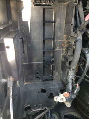

Pulled batt. Out tray squares full of water, not leaking from batt. Is this normal? Should I drill hole for drains? Going to get new batt. now, work tomorrow, any help greatly appreciated thank you!

It's not unusual for a bit of water to get in there.
You can drill holes in the low spots where the water flows to but check to see what's underneath first. You are looking for two things: 1) lines, harnesses, etc...that you don't want to drill holes into, and, 2) if drilling holes creates more exposure to more water coming in.
Your battery case is plastic so the water won't really hurt anything being in there.

Personally I'd leave it as is. If you drill holes and you do have a little leaking acid it's going to start corroding things underneath it. Better to let it catch in those compartments. By the way you might want to mix up some baking soda and water and spray it in there and see if there is any acid.

I'd leave it alone. Tray and battery case are both plastic so what are trying to prevent from happening?
Also the under-hood temps will dry it out very quickly when you drive.

I guess Im the oddball. I drilled when I found it back when I installed the Odyssey battery. Then heard how I spent too much on a battery. Cant take it with ya .
