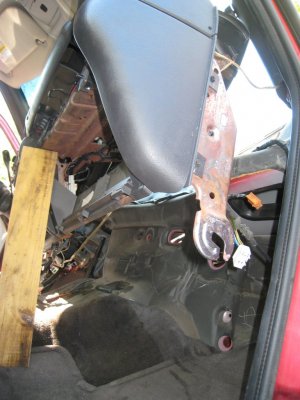

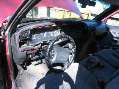

I changed it on my 99 years ago in my back yard and it was a pain in the ass but i was broke so....Basically you just get the whole dash loose and pull it far enough away on the passenger side to access the heater core. Totally doable in 1 day. I used a short 2x4 to hold the dash up and out far enough reach in there and change it out. If i remember correctly it was only like a $100 part or something too. You'll also need some cheap AC line removal tools and a recharge kit.IMG_1256.JPG IMG_1257.JPG IMG_1258.JPG

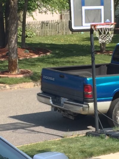

One thing to be careful of: if the truck is on any kind of slope, block the tires. Last time i did a core i got pretty lucky my brother's truck was 2ft behind mine lol. The dash being pulled back can change the gears or break what the cable hooks to

Exactly what happened to me 4327b30e6b186c1f2f6d2cb93a3948a6.jpg rolled down the driveway and pushed the duramax against the curb76f9c8797c803572a9b3a5830882f904.jpg
