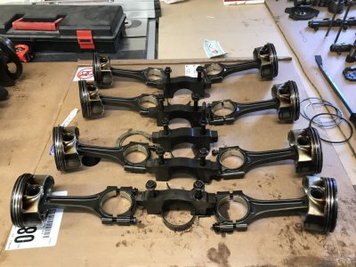

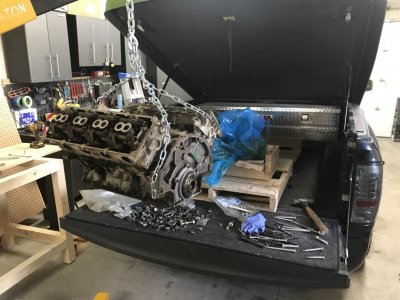

Did the tear down on the new engine yesterday. I had my nephew come over since he was interested in seeing an engine's internals so it was interesting going through engine basics with him. The good news is, there's no major damage that I could find.

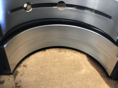

It turns out that the only damage that I could find was scoring on the #3 and #4. The cylinder walls were perfect and there was no indication of wear on the main caps. I might have struck gold with this block since the heads and cam were great as well so I can sell those and recoup the cost of the block purchase.

looks good, great bones to start with, Cool thing about the Nephew being curious. I know I'm happy every time I see my two nieces and their brother working on their rides.
Odd request for you, can you take a photo of the side of the block? water jacket to pan rail?.

I took another look at all the parts I pulled from the 6.4L block. I measured all journal and bearing diameters, rod length, pretty much everything I could think of, nothing was out of place. I then checked lifters, they were all good, but I realized my mistake. I only looked at one end of the pushrods as I’d stuck the other end into the sheet of cardboard.
I found the one legitimate issue with this engine: worn pushrod. This cost the previous owner a new long block, lol.
