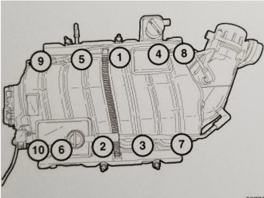

This hasn't been talked about for awhile,but check your intake manifold bolts.They call for 108 in-lbs or roughly 9 ft-lbs of torque,and they should be checked at least yearly,as they do loosen up. I've been doing mine at least twice a year on all 3 of of my hemi equipped vehicles.They should be checked and torqued when the engine is cold.I just use my calibrated hand and a 1/4" drive rachet / 6" extension and 5/16's socket and just give them a twist by hand,but if you don't trust your hand,an inch lb torque wrench should be used.There's 10 of them on 5.7's and 6.4's. I've done them enough,i know the torque sequence ,but if you don't know the sequence it's easy enough to look up

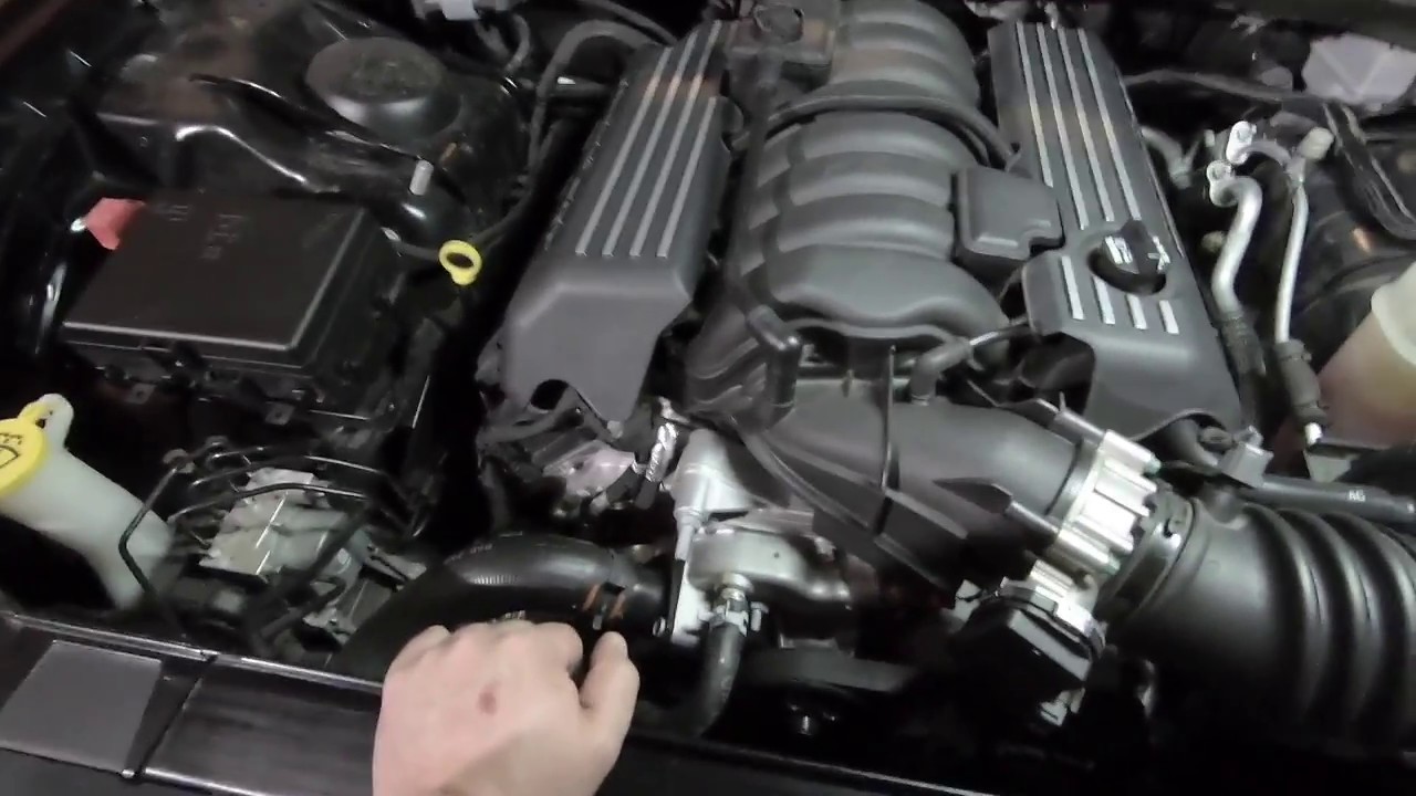

Also, I just found a video showing the torquing of the intake manifold bolts. It’s for a guy replacing the manifold on a car (probably a Charger) but around the 8:05 mark it shows the tightening sequence.
Sorry if this has already been posted.

Post #9 shows the torque sequence.
